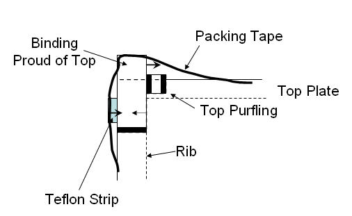

Jay what style of guitar are you binding? You mention "arch" and "recurve" -- suggests its a Les Paul style or an archtop. Also what kind of ledge cutting set-up are you using?
You mention you are going to give it a go with plastic. I use CA and packing tape like Brad suggests regardless of the type of binding I am doing. I'm not sure Blue tape is the way to go even when using plastic binding.
For what its worth -- I do mine pretty much the way Hesh describes. If you tape it all down with packaging tape you can clearly see if you are getting a tight fit. Once you've got it all taped down -- remove a piece of tape -- wick in CA -- retape...until done.
Another potential problem could be your binding is too proud of your top -- when you tape -- it pulls the the bottom of your binding away from the ledge.
